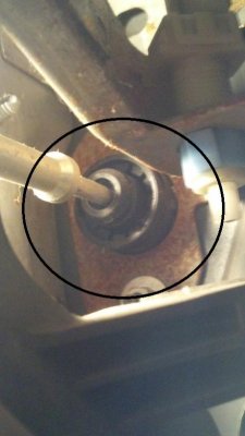

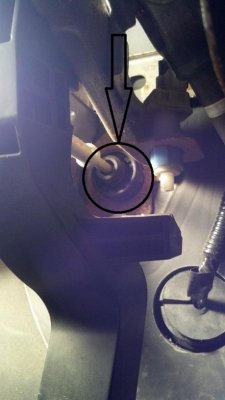

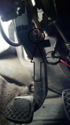

Here's the deal: ever since I upgraded my clutch to a stage 3, the required pressure to depress the clutch pedal has greatly increased. I assumed that this was simply due to it being a brand new clutch assembly. I did that about a year ago. I'm not sure if my issue now has anything to do with that issue or not but it could.
The issue now: I went to drive today and made it less than a block before I heard a "pop" and my clutch pedal went to the floor and wouldn't release. Upon later inspection, I realized that where the clutch rod, connected to the pedal, goes through the firewall, there is a boot. This boot had been pressed through the hole in the firewall. I was able to pull it back out but it continues to get pressed in every time I depress the clutch.
What I want: I would like for someone to send me a few close-up pictures of this part on their cobalt to see if I am missing some sort of pin or clamp or something to prevent this issue. Or to see if I simply busted the whole thing and need to replace it. The pictures attached refer to the part that I am referring to.
