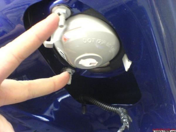

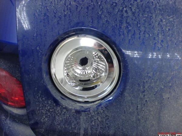

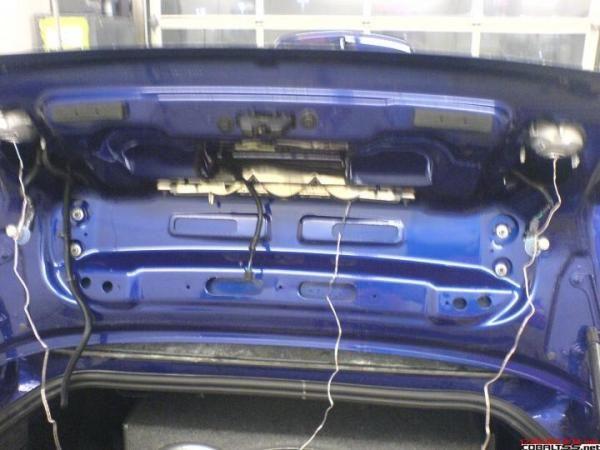

frist you need to remove the plastic covers that cover the reverse lights on the backside of the trunk.flat head screw driver and a slight twist and they will release from the trunk. then remove the carpeting by cutting the heads off or using a trim tool to remove the 8 clips holding the carpet on.now you can get started in taking the lights out.using a 11 mil socket take 2 nuts off that hold light in trunk and remove reverse bulb and socket with a twist
1.
2.
pry gently on the 2 little prongs on either side of the light to release them as well

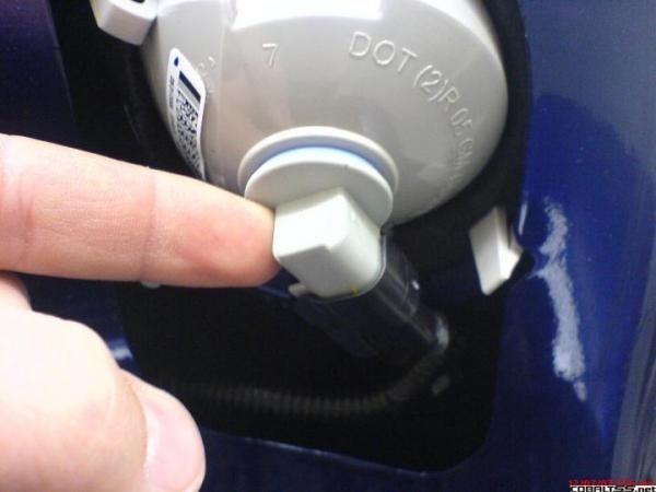

3.
you now have the trunk light out . . . yaaaaah

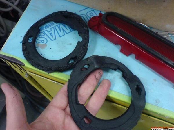

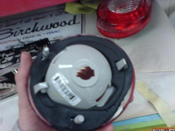

the black foam gaskets are next, be careful not to tear them while taking them off ! they are held on to the lights with a form of butal tape ( black sticky stuff ) this is very sticky!
4.

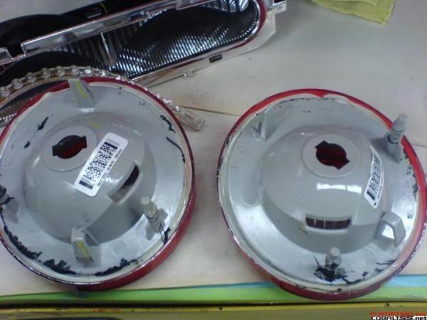

now you have the painstaking process of remove the sealent from between the lens and housing. i started using a heat gun but noticed the lense was getting to hot and with it being so thin, it would distort. i let it cool down and used a drill with a 1/8 drill bit to cut all the sealent out . drilling a small hole and then rotating lens around moving drill bit. be careful ,one slip and you need a new lens . her is a pic with sealent removed
.... an hour goes by . . . .
place the seperated lens back into the trunk lid so you know wich way is up and down

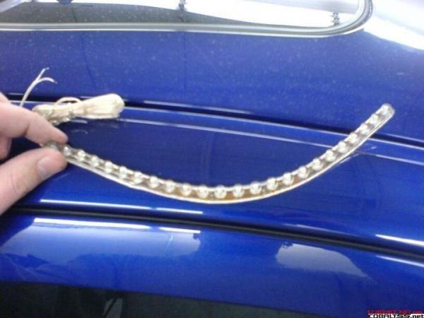

this is the l.e.d. i used , 1 per lens. sealed , flexible , can be mounted in the car or out of the car . . .good product picked up at local surplus store

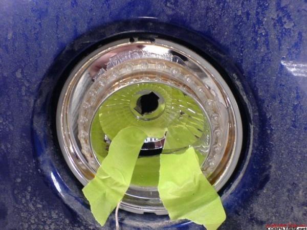

place l.e.d. in to light and position, remove l.e.d. and run a layer of glue around outer lens where you want the light to be. i used a 3m product called super fast adhesive for plastics ( i work in a body shop so it was readilly available lol )
tape is shown to hold ends in place so glue could set up

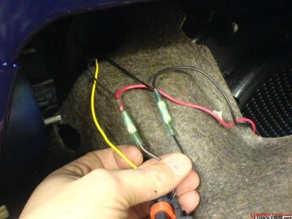

now the fun begins , run your lengths of wire form the pass reverse light all the way through the trunk lid down. down the wire loom on the right underneath to the area where your trunk light is located.hide all your wires and run them to the brake light on the passenger side.un plug the bulb entierly form the light so you have more room to work.
cut your brown and black wires only about 2.5 inches from the socket giving you enough room to strip the ends of the wires.do not touch wires together or you will blow fuses !
* if you do blow a fuse like i did, passenger side foot area # 9 , it's a 10 amp mini fuse lol*

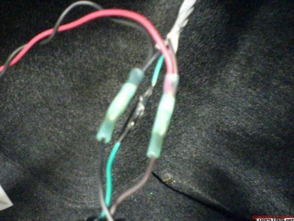

join your positive wire to the brown wire and join them all together. join your negative wire to the black wire. i chose to use the style of connector that i did cause it is also a heat shrink style.crimpit, heat it , black tape it and your done . no moisture can get in side of the conection.
plug light all back together and your done on that side

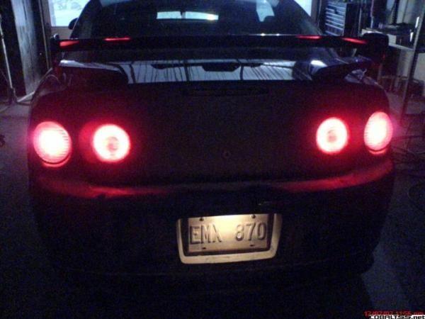

reinstall your black caps over the reverse lights and install carpeting back on trunk lid.close trunk turn on your headlights and shut the lights off in the shop and enjoy . . . you now have 4 running lights in the back and everything functions the way its supposed to ! have a smoke , you earned it lol
