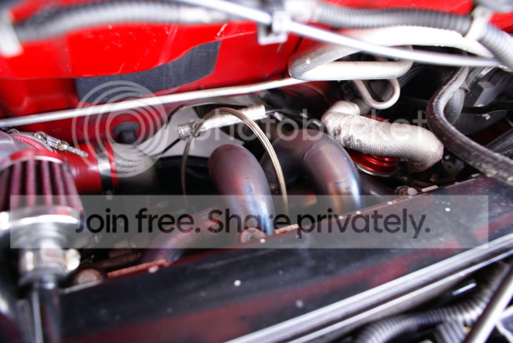

Tightened down the bolts on the Turbo Manifold. I tried the turbo with the Internal Wastegate on it again... saw that it was actually hitting the plate
that the Wastegate Actuator was attached to, so I ground that down... and it came a lot closer to mounting. But then the WGA really did hit the water
pump. It is seriously a cunt-hair of a difference. If I could hammer in the side of the WGA just a LITTLE BIT... it would fit. But I don't think that
would be a good idea. SOOO... I took off the WGA again, and then put a jack stand under the turbo and clamped the Turbo onto the T/M with Vice Grips to
see how see sits. Determined that I'm gonna have to run a screen on it, because there is no way I can get a filter on there. I think I figured out how
I'll be running my I/C Piping. Still need to remove the Windshield Washer fluid to be 100% sure on it though.
Once that was on there... I saw that there was no way that I could run a DSM O2 housing and have an exhaust, as the exit of the O2 housing was even with
the top of the engine cradle.

- My beauty... we haven't tried to stick it under the car since welding on the Wastegate Recirc, it'll be F'ing tight.
05/11/2009
- Pretty much have everything done. I still need to finish bolting up the wastegate, which might prove to be a large PITA, but I'm
sure I can get it done.

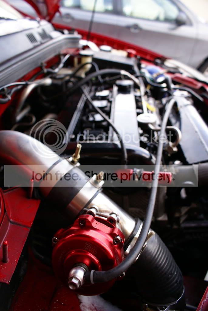

Bought and installed a Tial BOV.
-Compressor Surge is gone.
-Idle AFR dropped to low-mid 14's.
-And the car now pulls like an even harder raped ape.
Hopefully the non-opening HKS didn't **** up the turbo. Don't want something to break just yet, need this car this coming week. Haven't really taken it past 5 or 6k in 3rd. Next weekend is my last with the car... I will be pushing it to the limit... and probably on 15psi... not 12psi like I am now.
