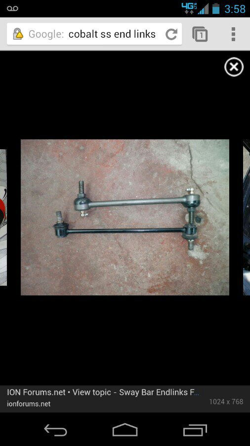

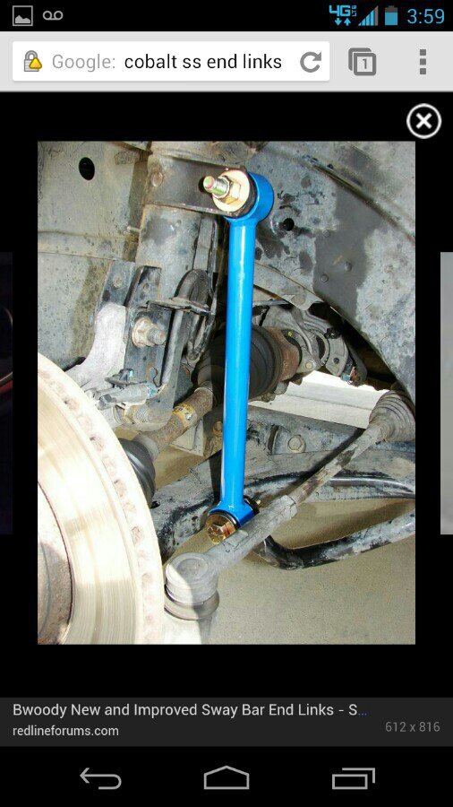

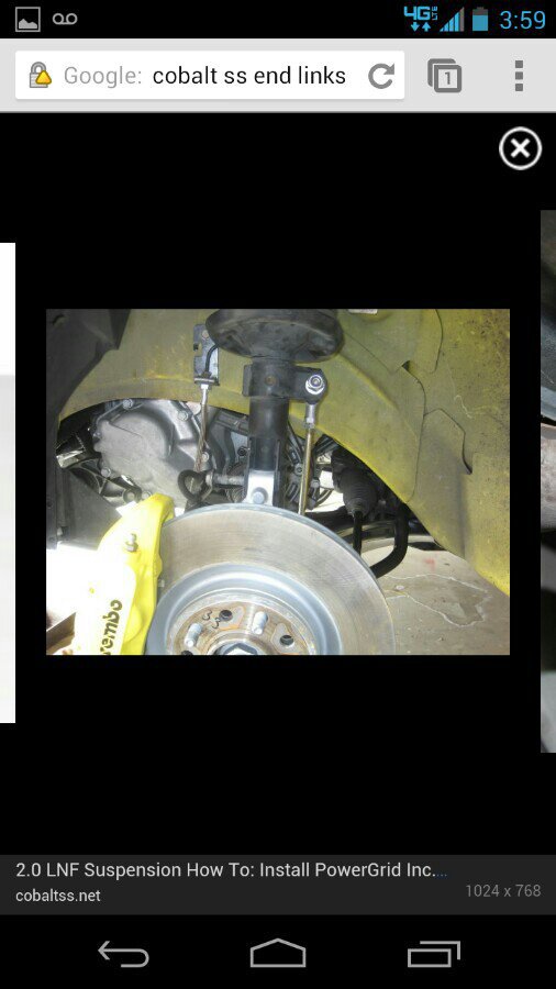

Ok. Relatively cheap. 50$ for both. They are Moog end links. They are the small lil dog bones connecting the sway bar to the struts up front. I just read up and ppl with sport lines switched from fe3 to fe5 end links to compensate for the low. Go to an autozone or advance auto. They are for "sport suspension". Or tell them you have a 2007 cobalt ss supercharged. They will give you the right end links. They easy to replace. I'll get a picture.
---------- Post added at 04:00 PM ---------- Previous post was at 03:58 PM ----------
The last pic is to show the difference in size. Don't worry about it being blue. Or black. Also there are adjustable end link but more money.
