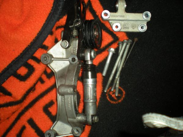

picture.php
close to all the parts, need the bolts now
and awesome, ill use my own

btw is that the intake mani lower mount in that pic
Jn2
1,847
yeah, take a pic of everything in one place, ill tell u whats missing...get everything u have now in one spot and snap a pic...ill see what missing
