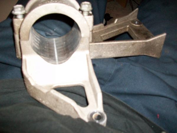

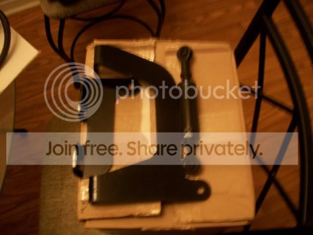

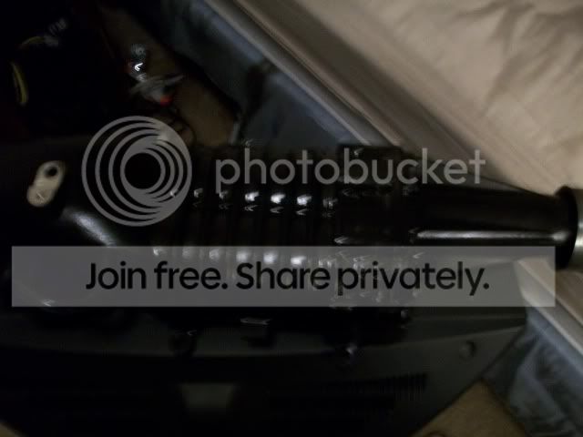

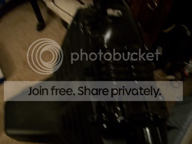

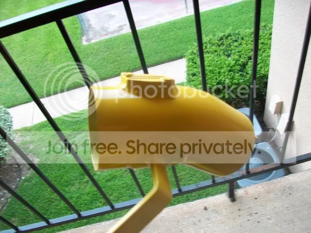

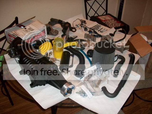

Now for the Parts I Have
A Little Information about the supercharger, pretty good condition picked it up right at 32,000 miles on it for 300 bucks shipped. The CXR intercooler i got for 100 shipped, the header for 20 buck plus shipping, the pulley(which im not sure which one it is) was 10 plus shipping. Oh and the injectors were 30 shipped.

keep up the good work,
and tape up all the entry holes on your m62 while its off the car, you wouldnt want to suck up a ton of dust and hair on your 1st start up :)
