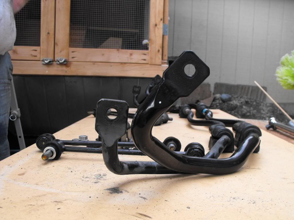

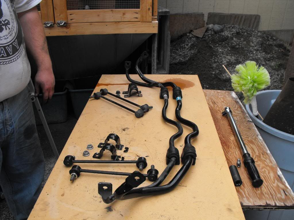

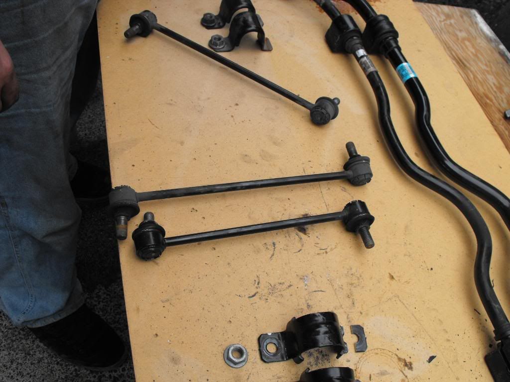

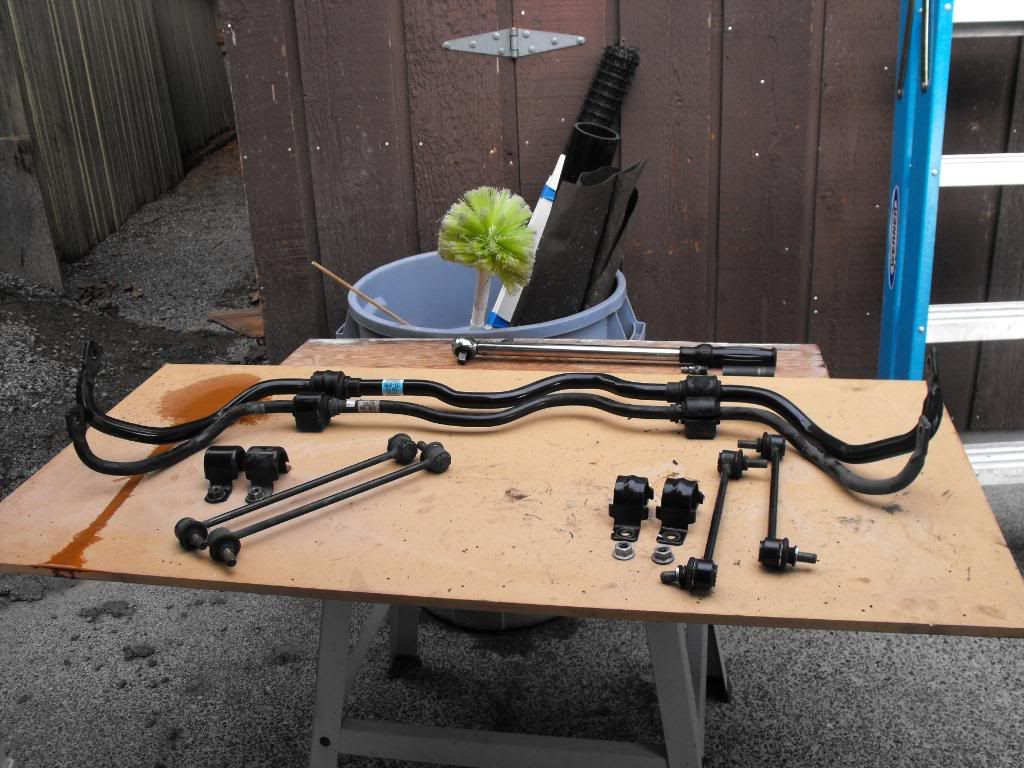

youre gonna need 2005 SS/SC sway bar bushings and reuse your stock clamps or youre gonna need to drill holes in your subframe to use the SS/TC bushings and clamps

ok, so i wont be able to use the ones on there, ok, so stock ss/sc bushings in MY stock existing clamps will let me use stock locations
how hard would drilling new ones for the ss/tc ones be?
Ced carries the bushings and clamps, pretty cheap too.
