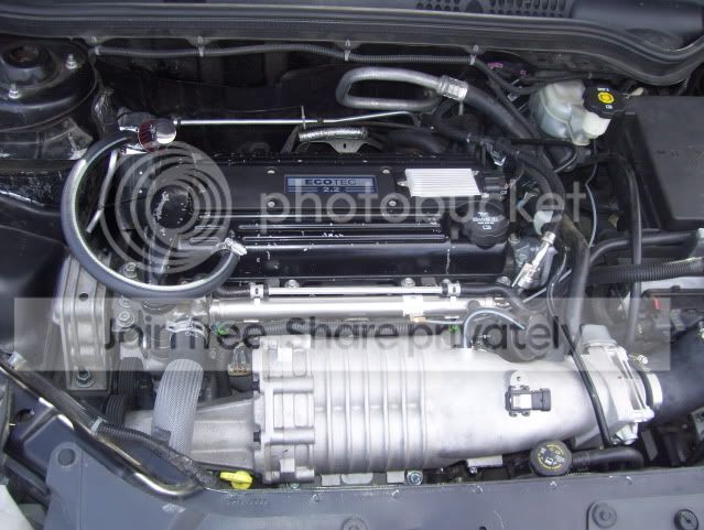

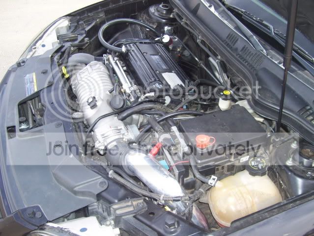

well ive decided to s/c my ride 06 2lt auto updated: car is up an running now the install went perfect
:rockit:
parts i have:
m62
LSJ intake manifold
LSJ lower intake manifold bracket
LSJ belt
LSJ idler pulley
LSJ intake manifold gasket
-m62 gasket
LSJ upper radiator hose
bosch intercooler pump w/bracket
plugs
aftermarket air intake
heat exchanger
60LB injectors
3,114
M-Town,AZ
