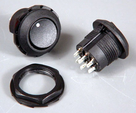

that's a bit big i prefer flush mount switches makes it look so much cleaner and sometimes it may even look stock
hey thanks for letting me know. Radio shack has this one you posted so im going to go pick it up. Make it look close to stock. Anybody know the best way to wire up the switch.
same switch i got for my foglights
on mine there is 3 prongs that are coming off of it
prong 1 goes to a fuse tap
prong 2 goes to the fogs ( in your case the LED's)
and 3rd prong goes to a ground ( i found a nice ground under the dash where the ebrake is)

Yeah i think i have the wiring figured out and going to do the project this weekend. The lights have been sealed and been sitting all week. I have picked up the add-a-circuit, lighted switch, 3 amp fuses, 16 guage wiring. Fuses 21 and 22 are hot to when the car is turned on so i can use any of those too. I am going to use one of those with my 3 amp fuse and will be fine.
Here is a picture that i think will work.
