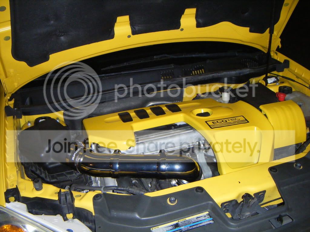

i was thinking of doing the airbox mod . has anyone done this ? i was think of doing this taken the silencer out and useing flex pipe in its place to help get colder air to the filter . also what filter should i get ? only reason im thinking of doing this instead of a cai is ....."wife" lol . kinda have to do it the cheap way

Or go to pepboys or autozone and get a spectre intake. They got different size tubes and filters. Also for the maf to hookup

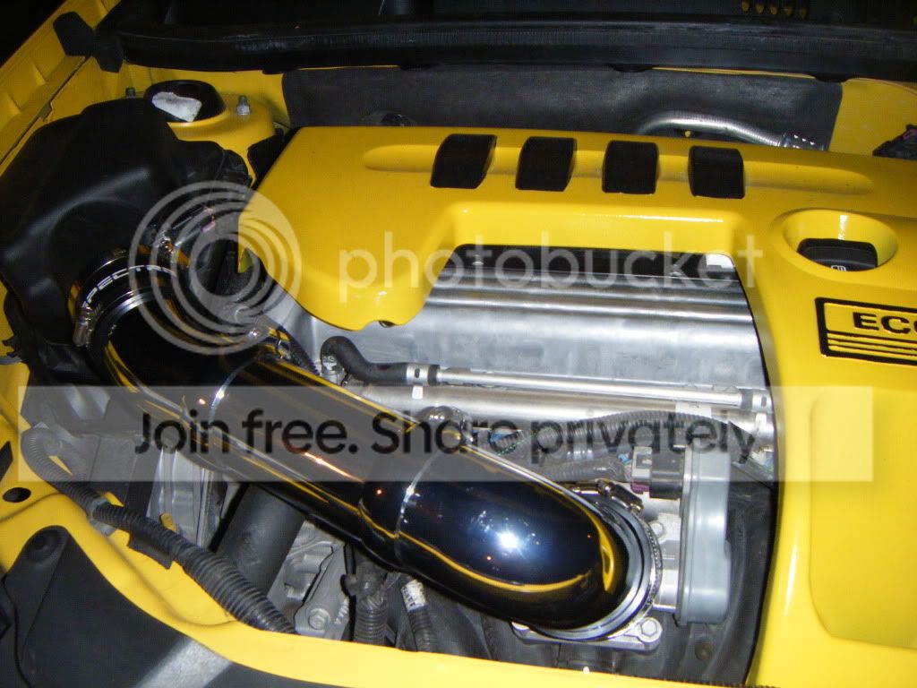

Well the spectre in take has different angle sections that you buy. About $12 each. They also have filters like k&n and injen style. Filter is about $20
You probably need 4 sections. Go to autozone and check it out. Pretty cool stuff
To make a specter intake for a 2.2 or 2.4 its about 100 in parts from vatozone, better off buying an AEM intake or similar, thats what i did when I had my 2.2

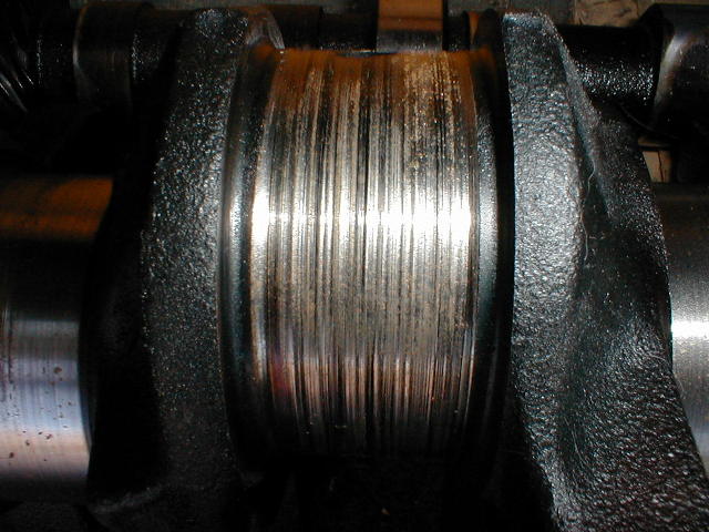

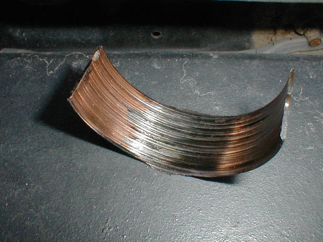

stupid stupid stupid. go change ur oil before you further damage your cylinder walls and create a blowby problem and damage your rod and cam bearings. small particles of dirt are now floating in your oil acting like sand paper scraping your rod and cam journals. yes one day with no filter can cause major damage.
journal wear
bearing wear

Running without an air filter will score your cylinder walls PERIOD! Now cycle the oil throught the oil filter enough times without an air filter the oil filter is going to get clogged there's something in it called a bypass valve which will bypass the filter bucko. Plus smart guy the intake is going straight into the combustion chamber so that means that the oil filter will not make a difference if its going straight on the piston rings and cylinder walls. Keep running with no air filter and prove my point go ahead. and if I remember correctly you stated you ran a FEW days anyway. Yes 1 day with out a filter will cause damage. Why the **** do you think they invented them in the first place.
