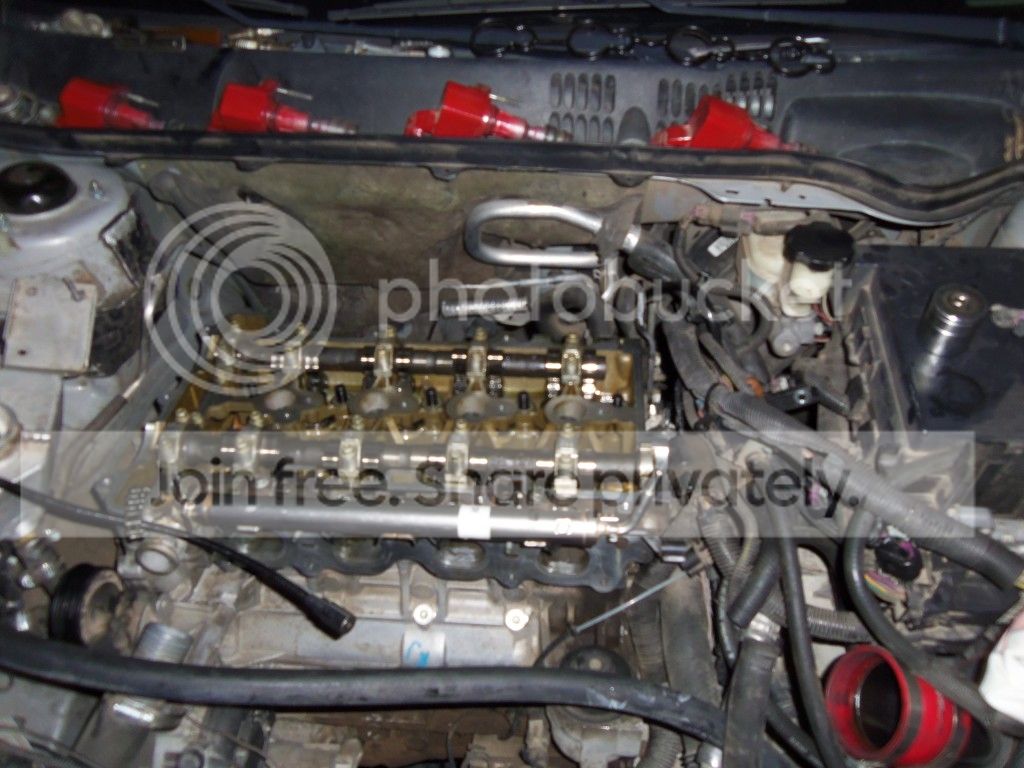

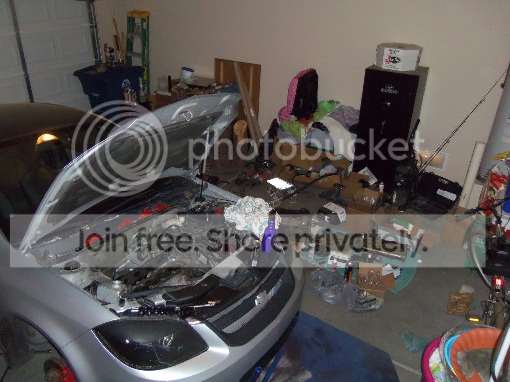

Back with a build.2.2 SC build thread.
Well I have been out for a while but back.Timing chain tensioner gave out and the intake cam jumped some teeth.Now going full forged.

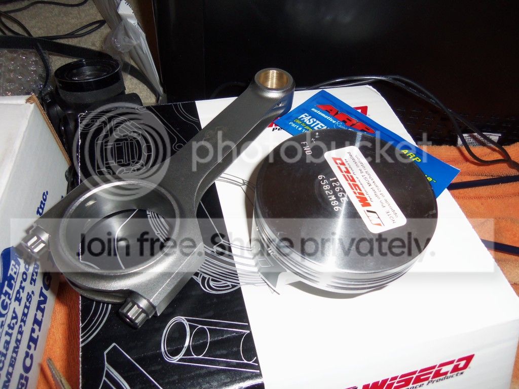

Eagle H beam rods,Wiseco pistons(10:1)

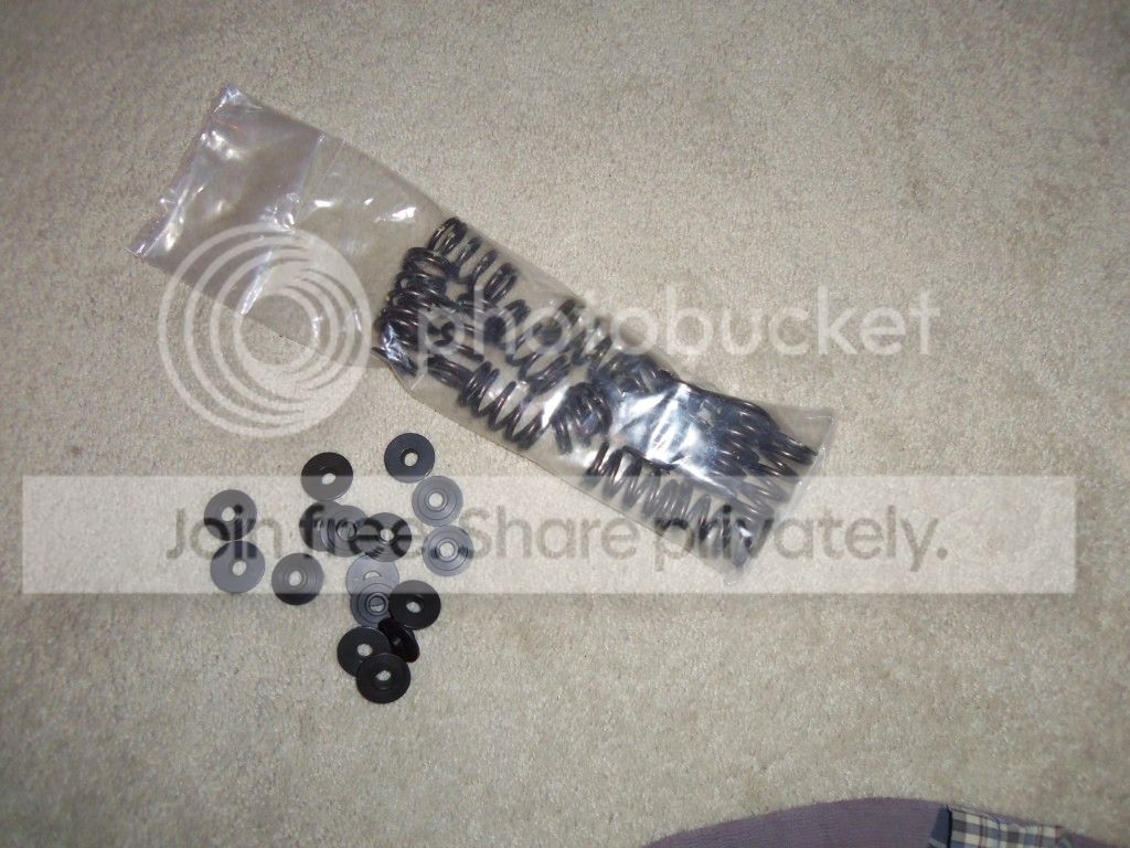

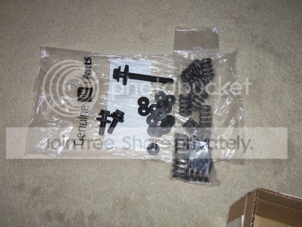

ZZP 82# springs/retainers

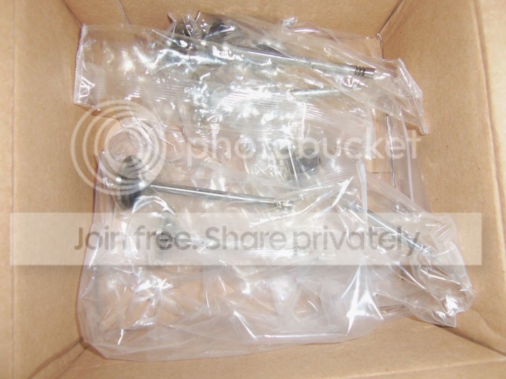

OEM replacement intake valves.

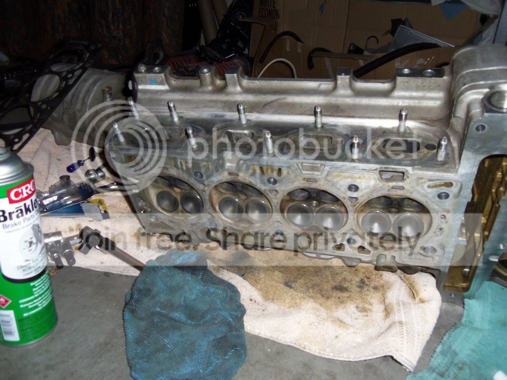

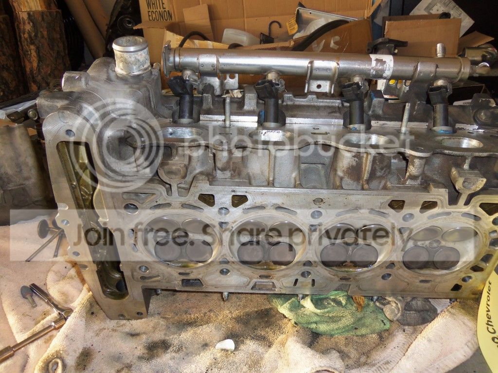

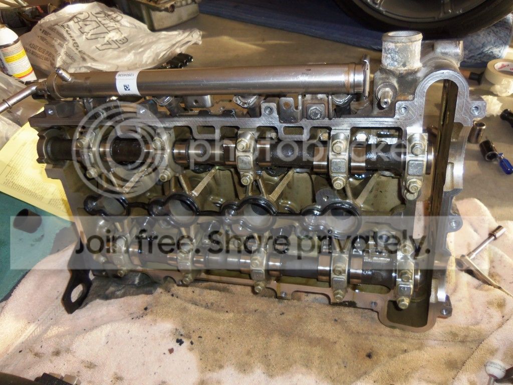

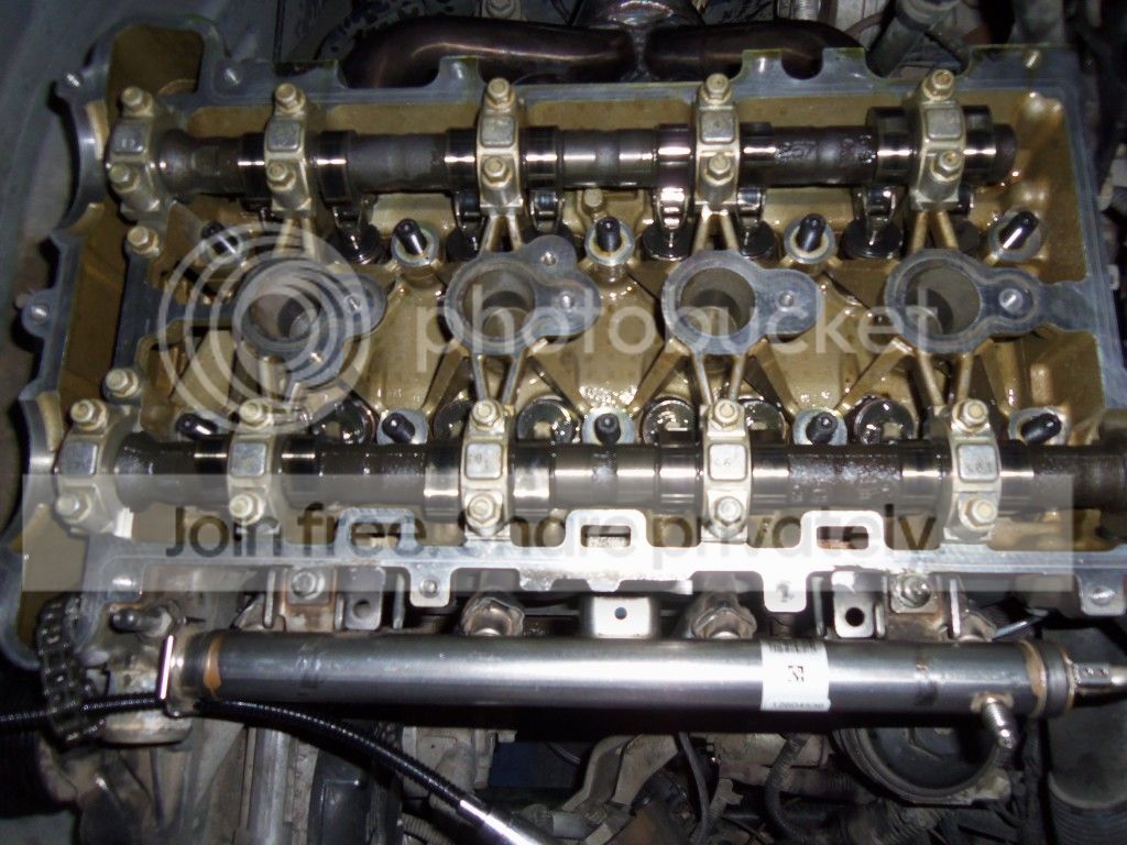

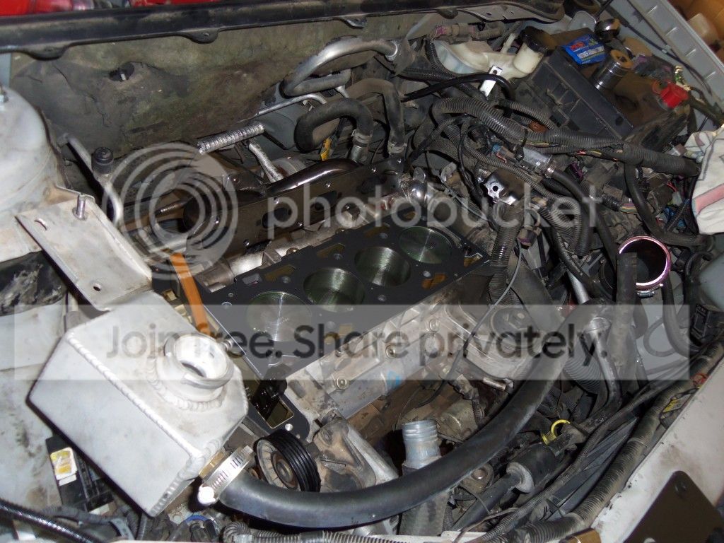

Cleaned up the ports on the head quite a bit,Heads back together,block is honed out,pistons are in a torqued down.I will update tuesday.

If you don't mind me asking, how much were the piston and rods, and where did you get them? I am thinking of doing this with a higher compression piston since i will never do any forced induction in mine. Just not sure what the $$$ will be and can't find a site that has any cobalt internal engine components.
BankDude
Sep 29, 2010
384
rods/piston combo on ebay for 775. i'm in the same boat. i blew up 3 pistons, screwed my valves and cracked my crank. just got the engine back in pieces on friday and have been doing little by little to get it back together. zzperformance, turbo tech racing, modern performance, over the top performance, wiseco, eagle, supertech. those are companies you're going to want to get parts from. the only way you're going to get higher compression is to make a call to wiseco and have them custom build a set of pistons for you. keep in mind that rebuilding an engine isn't as easy as just replacing parts. there's machining and clearance checks you'll need to also

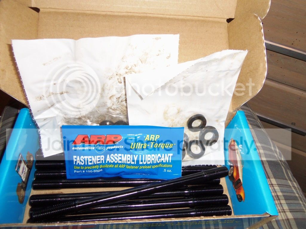

Real street performance in Florida is where I got the pistons/rods.Crate engine depot for bolts that are TTY and have to be replaced,TTR,ZZP.I'm on a M62 with a 2.9 pulley and E85,so she will scream when back together again and the fuel cut will be moved up to 7800.
