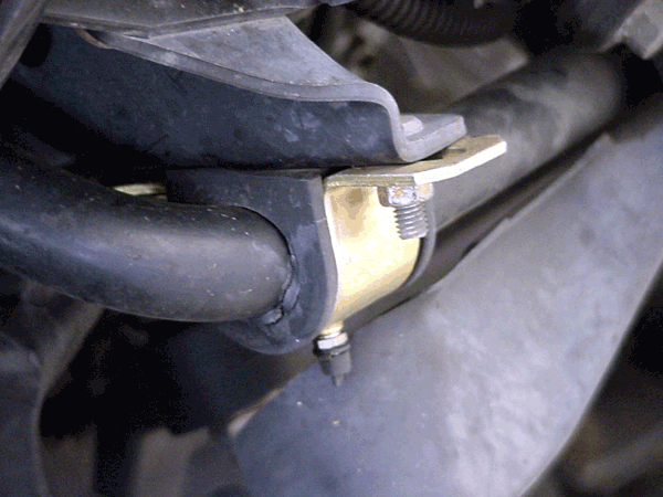

Yes they are off my LNF.
nice, if she doesnt take them, if you could let me know how much u would let them go for shipped that would be nice :)

i won't know the 'damage' until i can actually really look which will probably have to wait until friday
there located on the swaybar you will see them if you follow it under the car.
