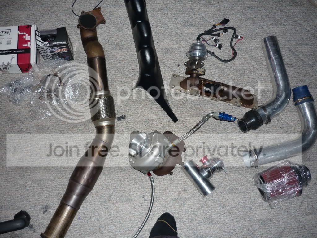

i bought this turbo kit on a whim because i got swindled by jbp on their cams and lifters so i saved some money and got a refund and scooped up a gt30r turbo kit for 1350 shipped on css...steal of a freakin lifetime.

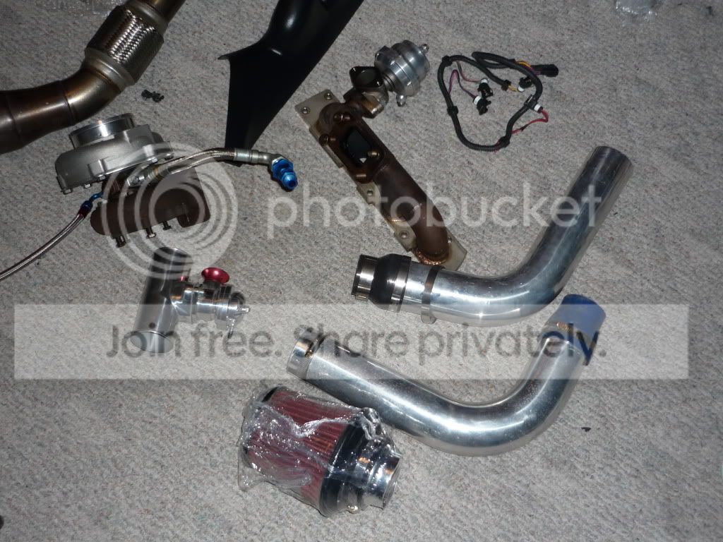

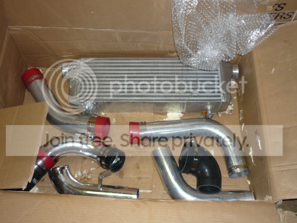

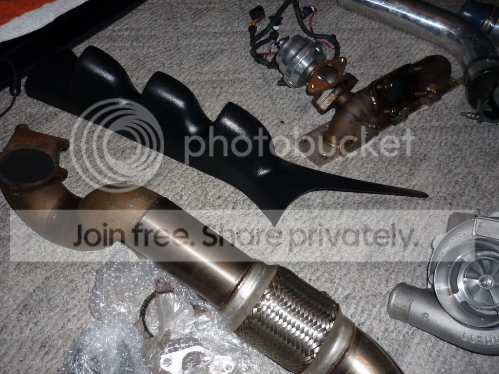

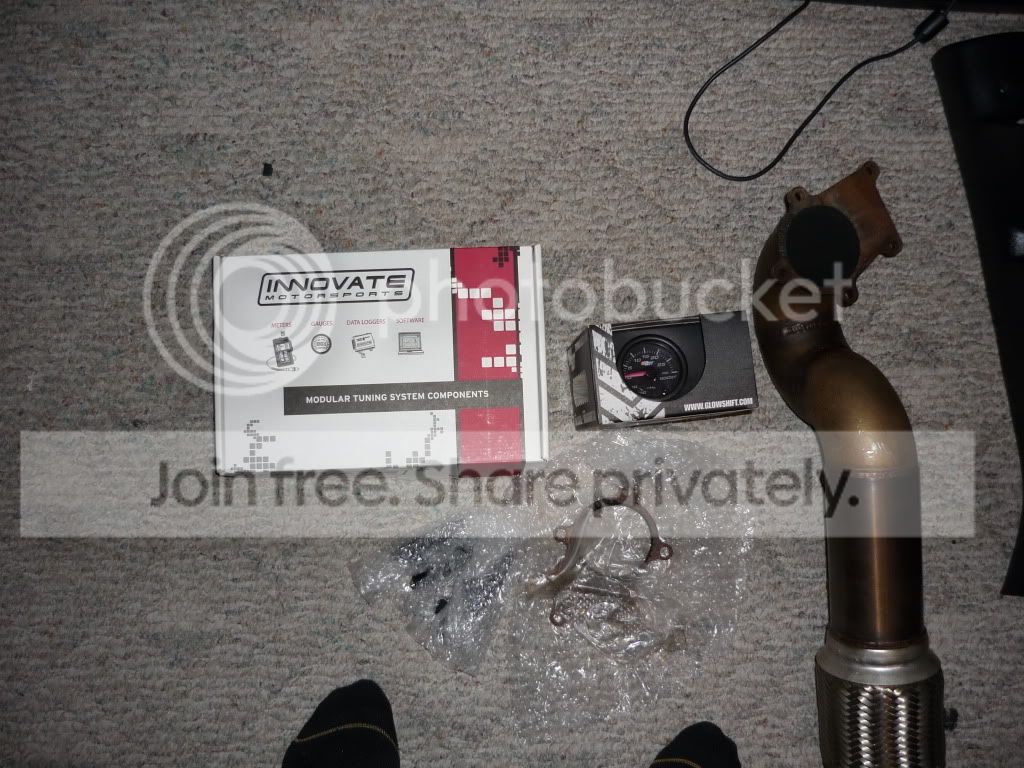

included was
gt3076 turbo
3" charge piping.
log style manifold
3" dp
tial 38 mm wastegate
oil lines and some fittings
intercooler
lsj 60# injectors
stuff i added to the kit:
type-s bov (temporary)-probably pretty loud

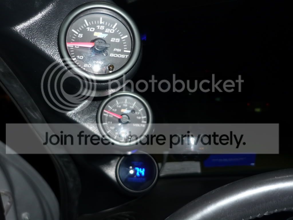

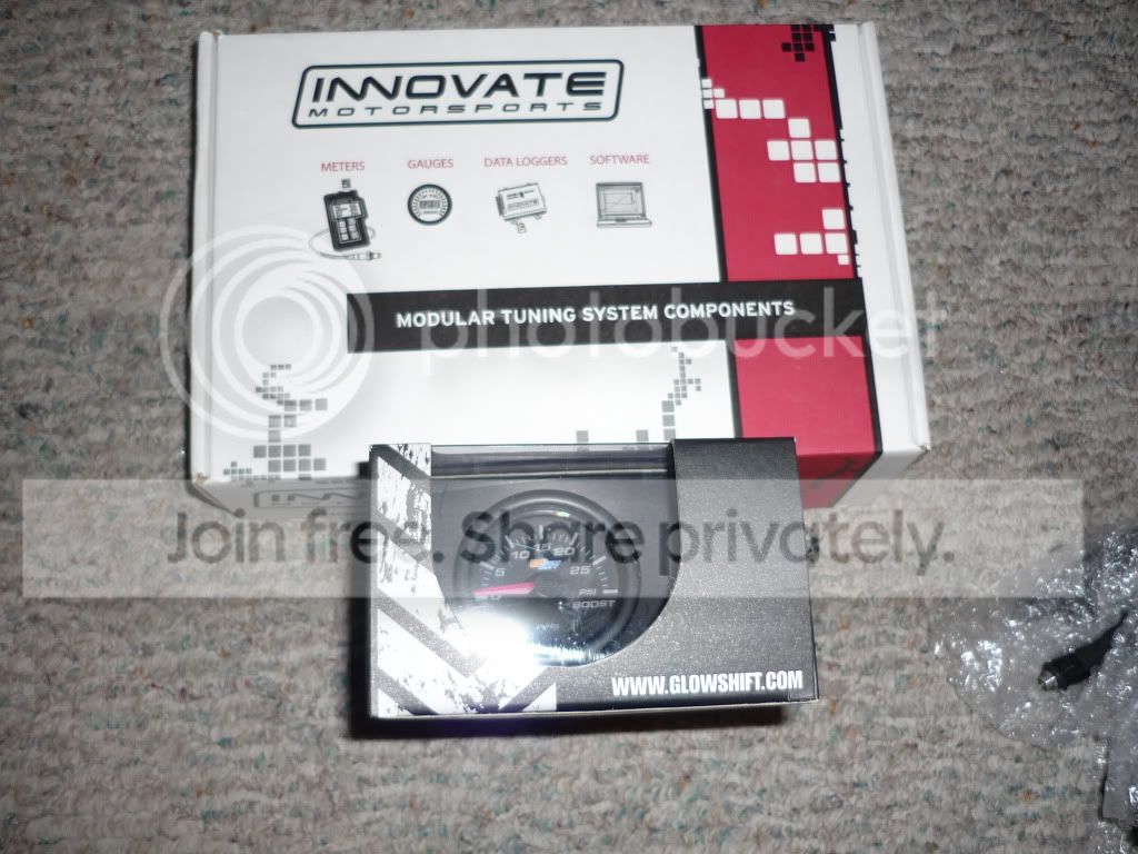

Glowshift boost and volt gauges (7 color)
Innovate db blue lc-1 wideband
3 pod a pillar
Trifecta tune
sold the lsj injectors and got 2.4 specific injectors

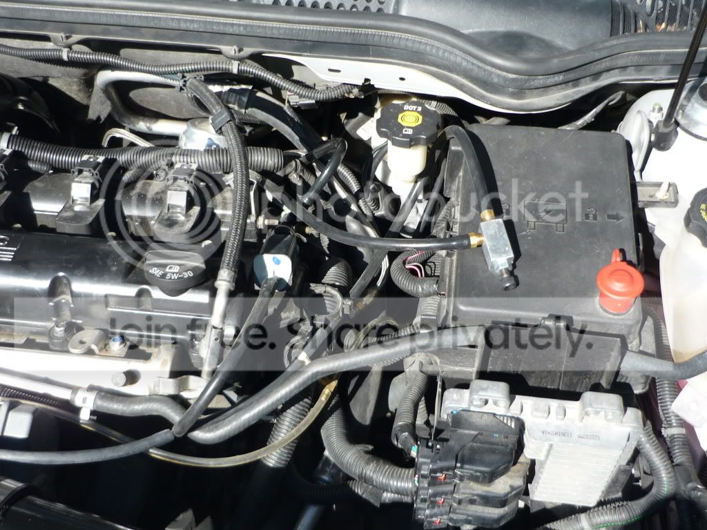

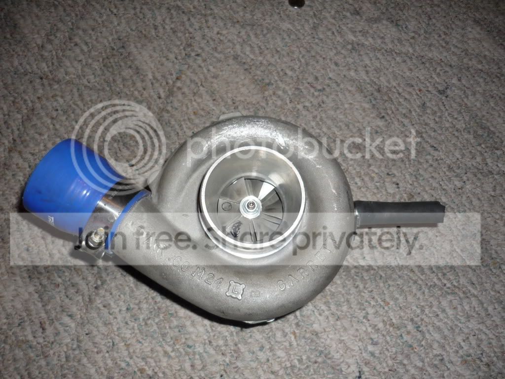

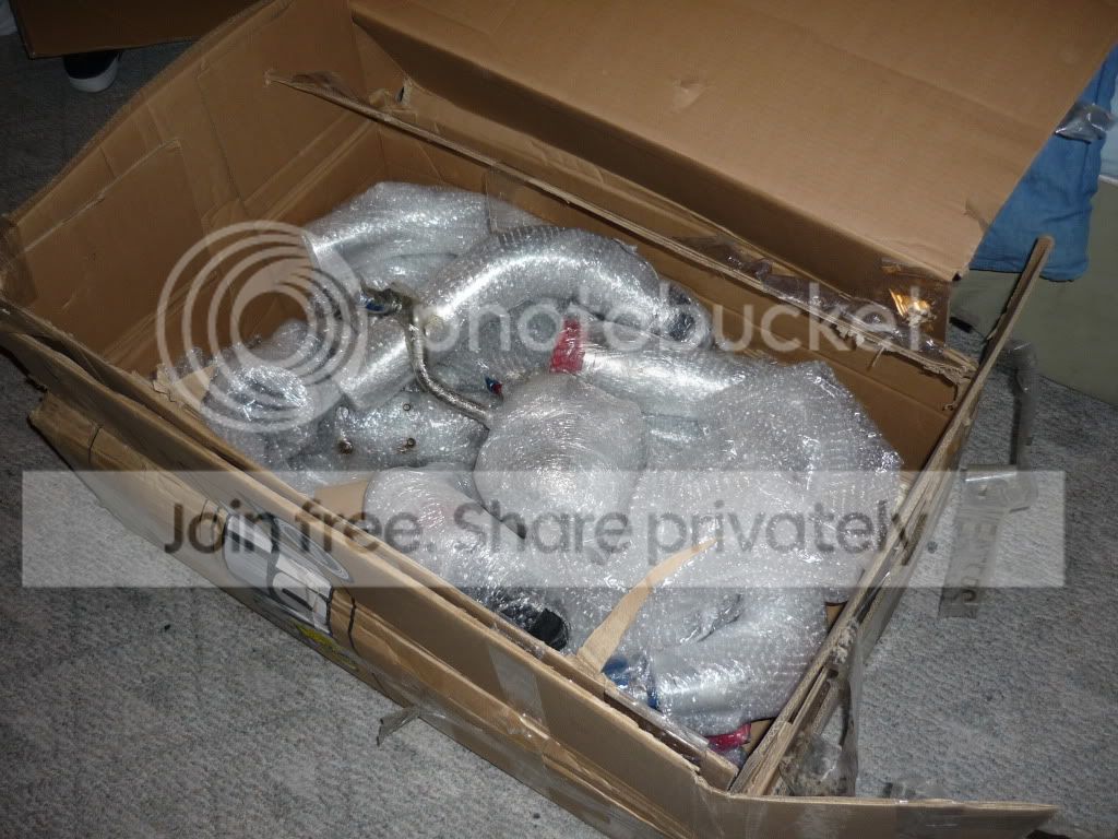

pics of the original stuff..

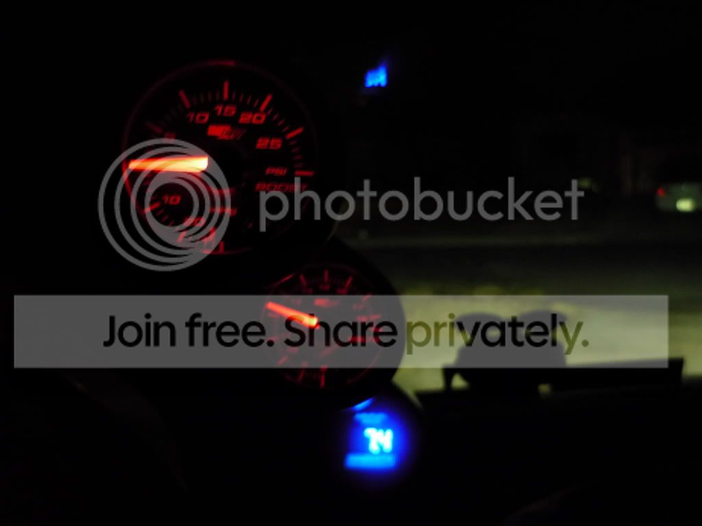

Gauges

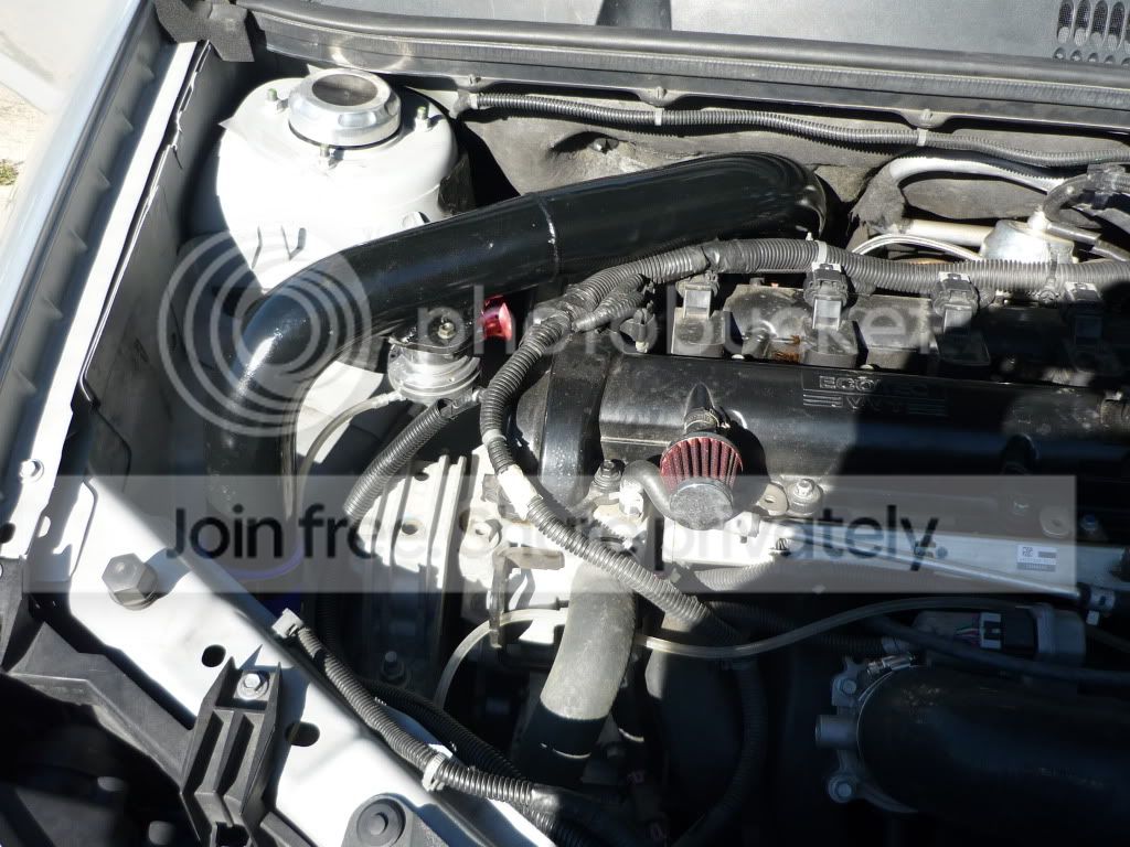

due to install fail and BAD direction and help from friends. the gt30 was killed. long story short. do not use teflon tape ANYWHERE near the oil feed line. thinking about it pisses me off cuz the gt30 is a beautiful turbo and would've gotten me to my goal EASILY.

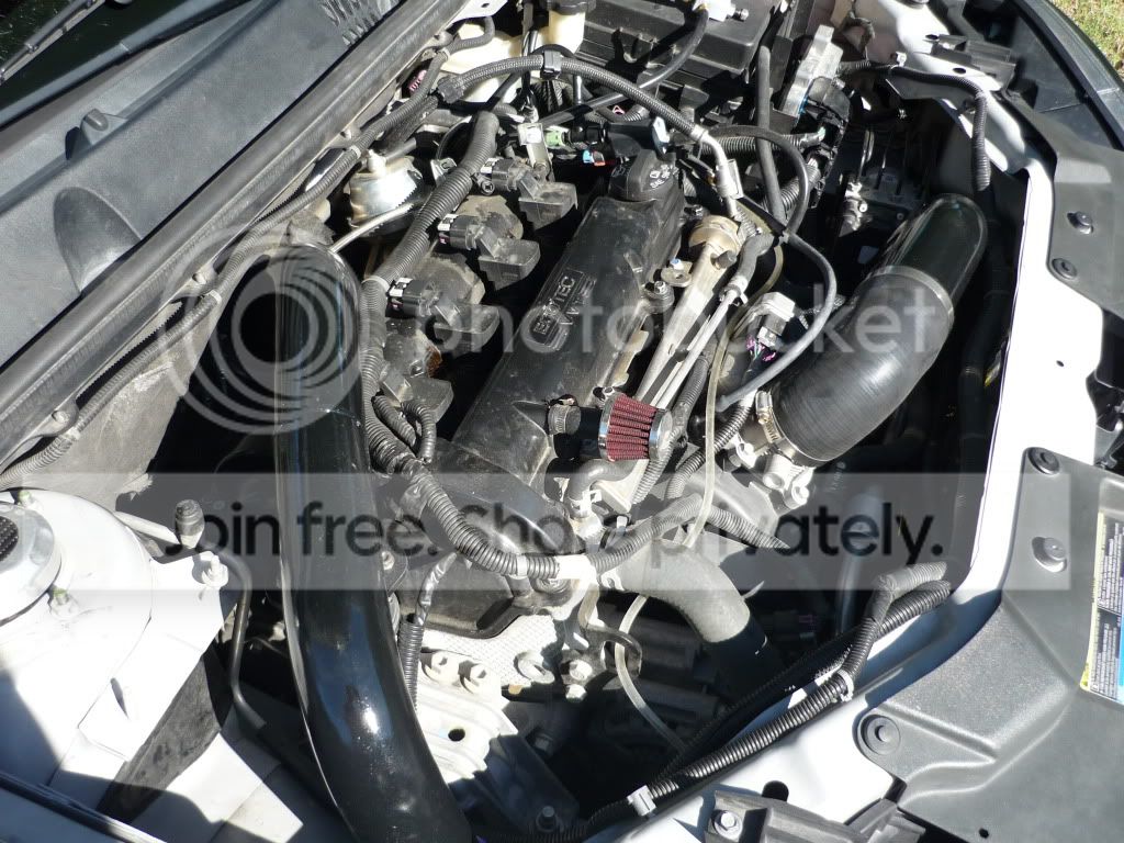

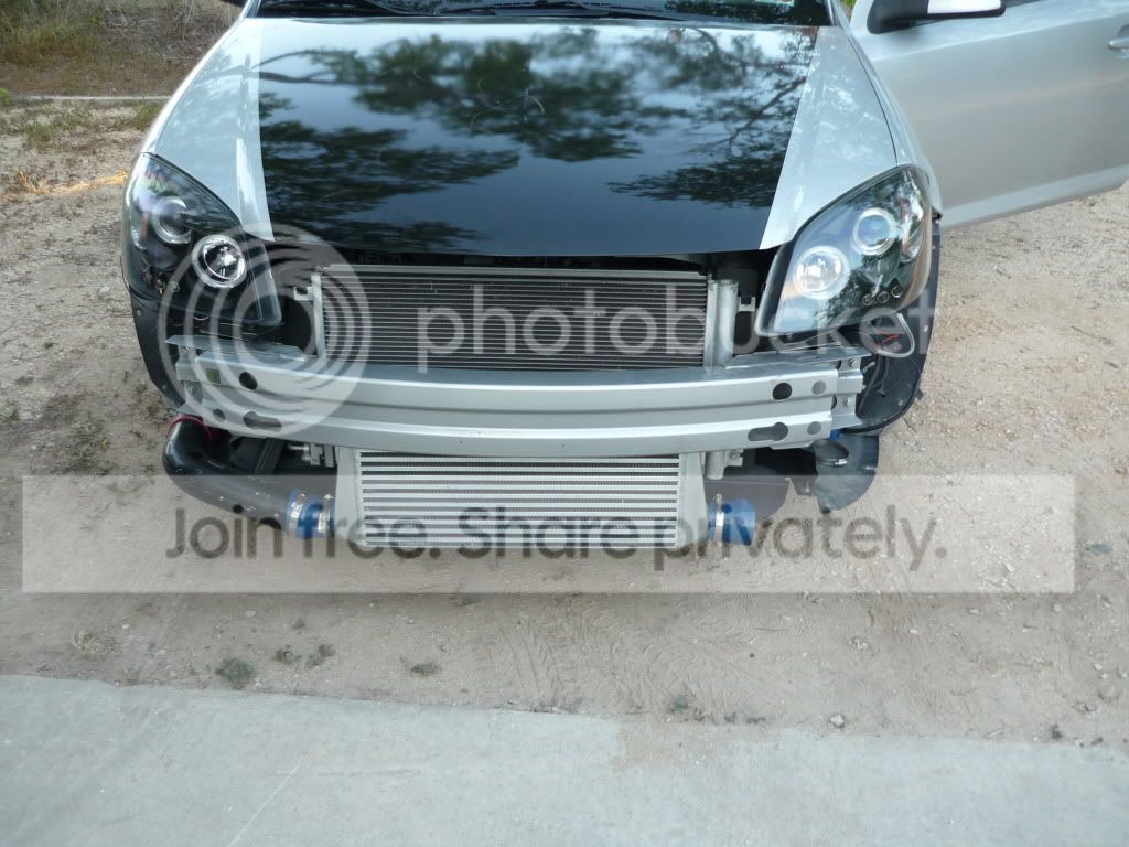

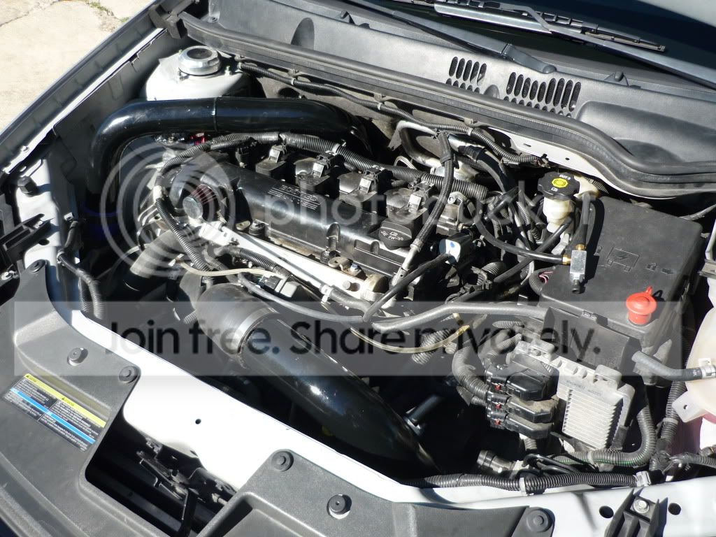

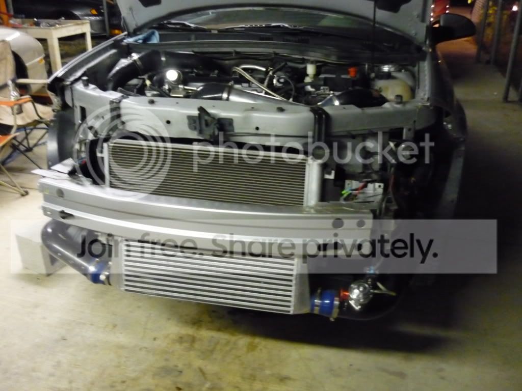

some install pics from the tear down and install day august 14th and 15th. 2 weeks after purchase of the kit.

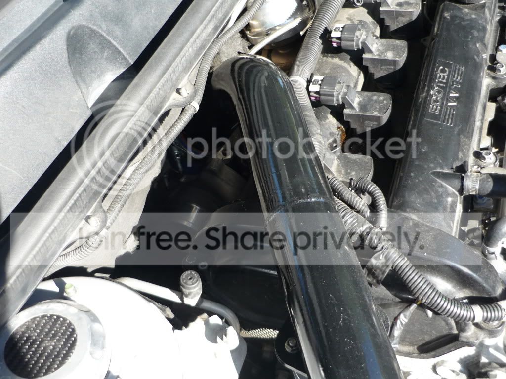

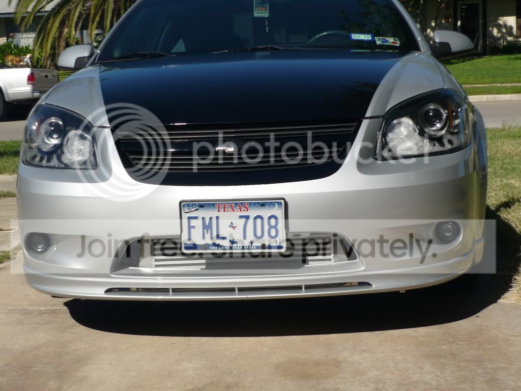

shows u how my piping was routed..because of how big that crap is i had to lose my driver's side fog light..
i lurked the forums and got a new t3 t4 garrett 50 trim to replace it.. and at 7 psi with this turbo ive been able to kill

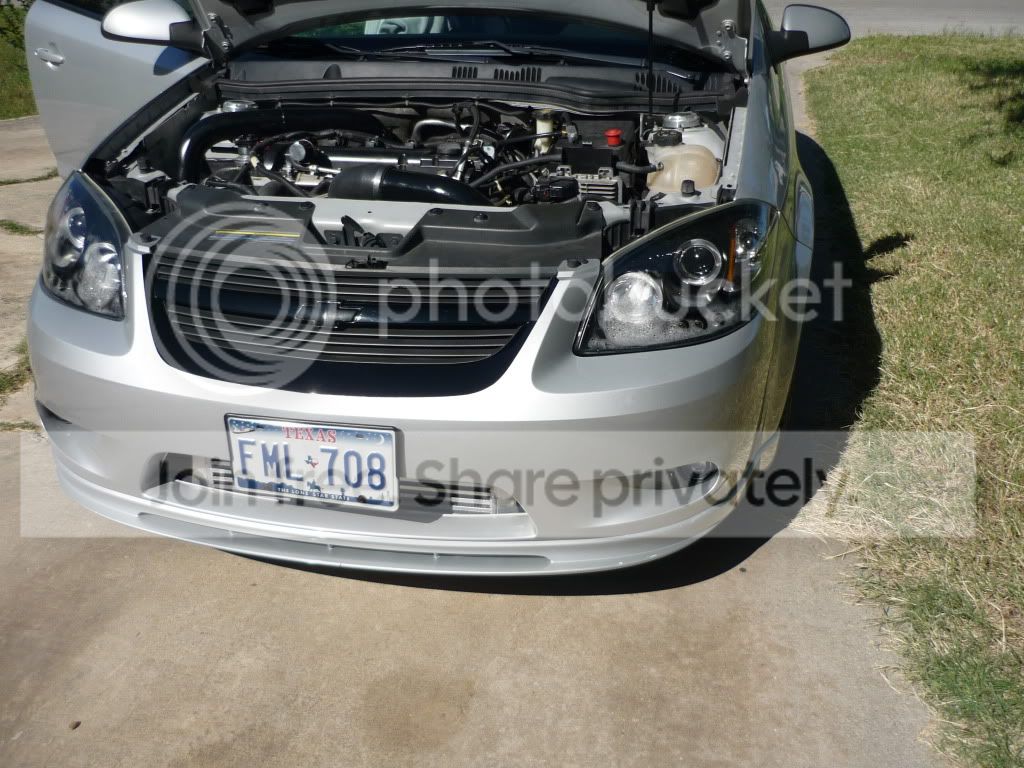

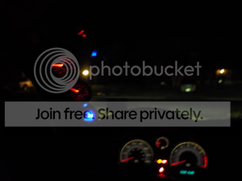

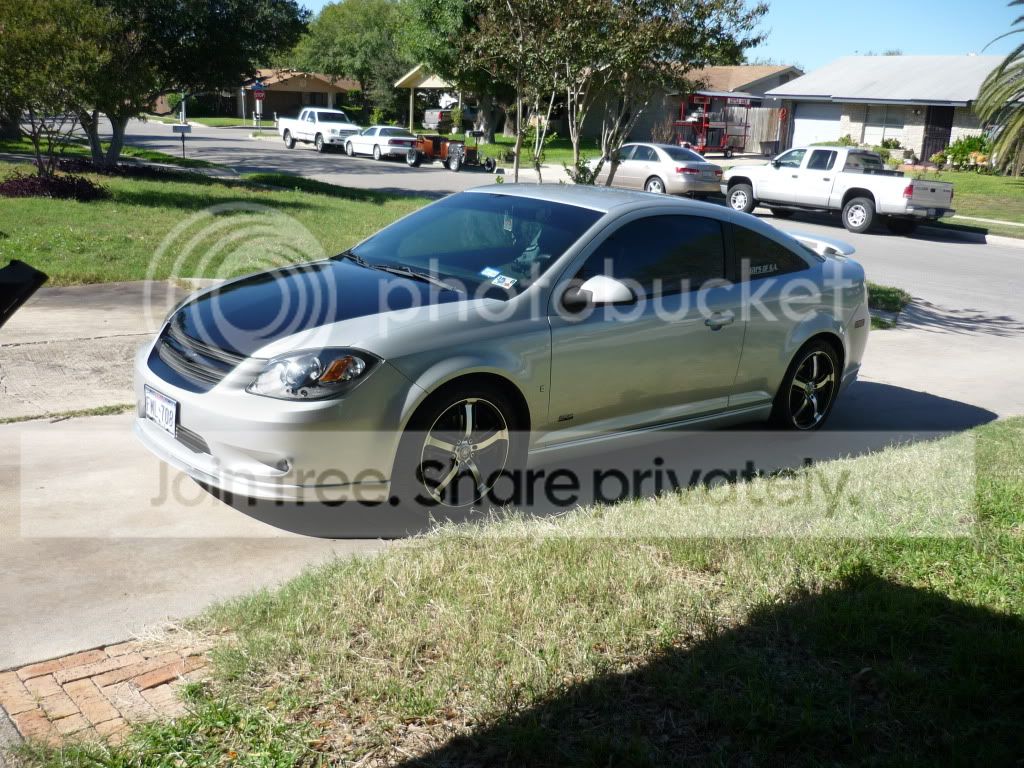

so im pretty happy with it.. here's wut it looks like
sooo to sum this up..
