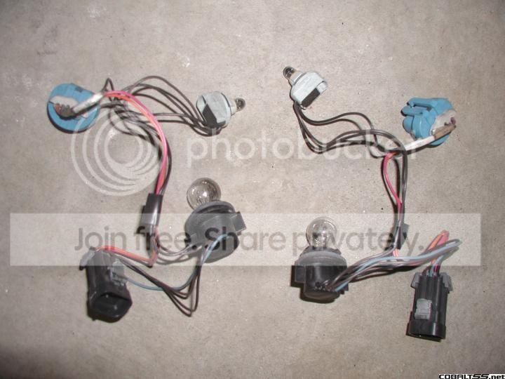

Now the issue, in my removing of the assembly I discovered the entire wire harness sas croaded from the water. One connector, blinker, will no longer transfer power, I did troubleshoot and try new blubs. I have been looking for hours and can't find just the wire harness. If anyone knows where please assist. I have searched the main auction site.

I got some spare wiring harness at home. I'll snap a pic of the harness I have at home. They have the bulbs for blinker. The blue connector for the headlight halogen bulb. And the small light bulb for reflector. All that with the main black connector to connect to the actual engine bay harness. Is that what your looking for?
