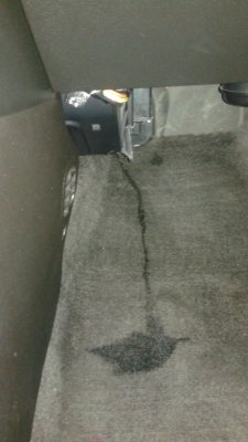

Water leak on the passenger side.
duke8804
Jun 29, 2010
9
I honestly do not know where to start i was thinking of checking the fuses but not sure that will do much for me. I am at 39000 so i am out of the bumper to bumper warranty. I have Easy Care going to see if they cover it. If they do not does anyone know where i shut start? I am thinking that all the water that was coming from the condensation build up affected something electrical, but i would assume it would have affected that before i fixed the clog when all the water was in there not when i get all the water out. Oh and the AC makes no noise anymore when i turn the fan switch up. Neither the heater nor A/C works.
I wish i didnt need it either but when it is 104 degrees and 80% humidity outside everyday it becomes a bit much.
